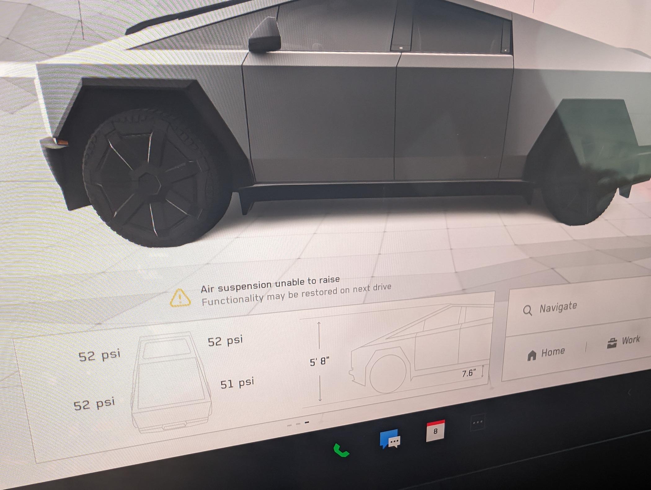

Anyway, driving home we stopped at restaurant. I did a suspension increase to see what it looked like. Then lowered back to normal.
Drove some more and heard a loud hiss....sound like a tire blow out. Got message on screen...Air suspension unable to raise. May be restored on next drive. Not.
Also see an alert for Unable to charge. Must have happened when they were trying to charge for delivery.
See image. It's hot 94 here in FL. Next to tire pressure it says ride height is 7.9" in Comfort mode with ride height "higher"
Is it broke already?

Yes, sounds like a pressure line popped. It'll need to be fixed, but you probably can drive.

Started a roadside assistance session. He said to try the 2 button reset which I already tried. He said it was ok to drive but might be speed limited. Got down to 7.5"

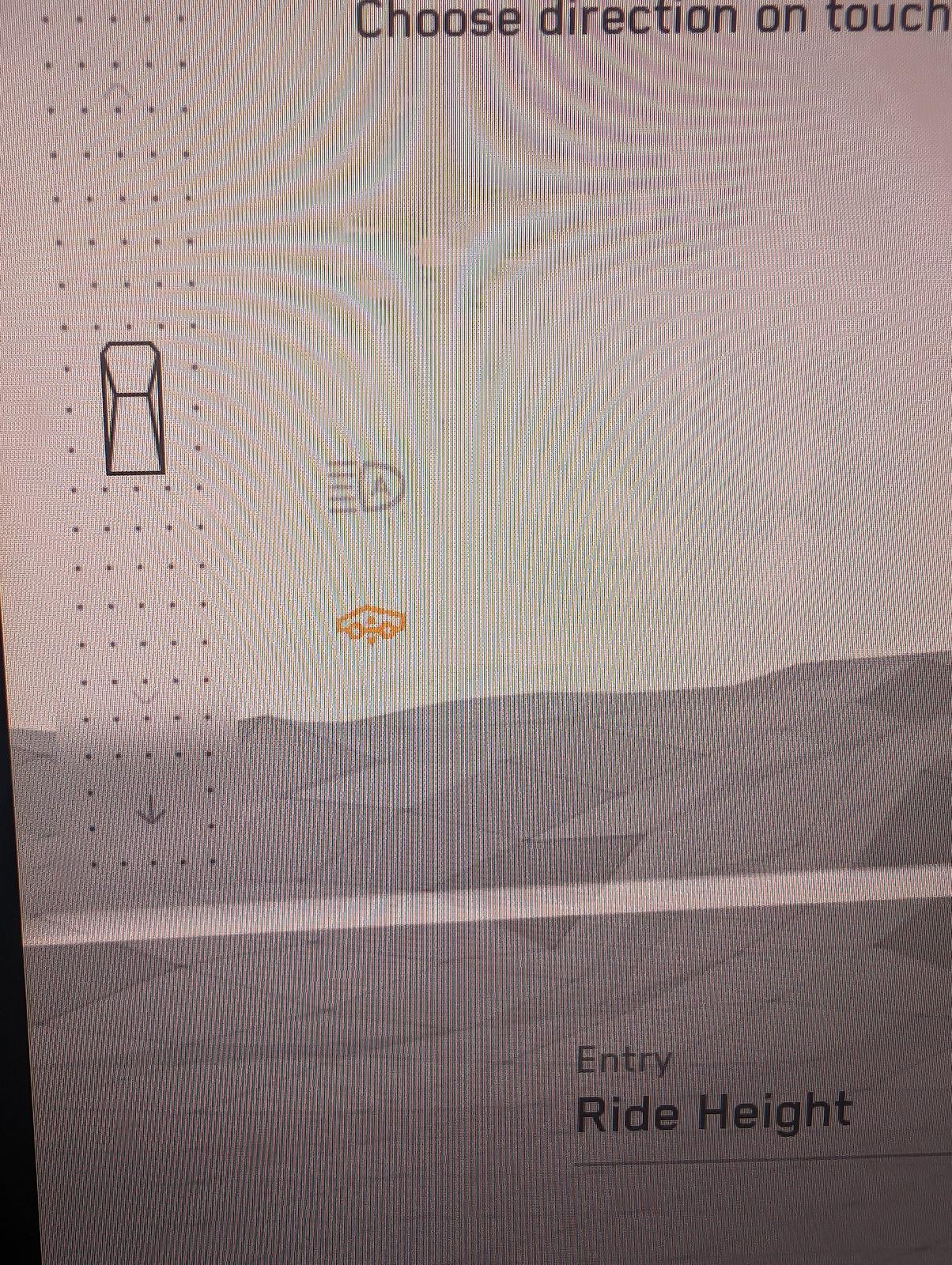

Also have warning light on display. Will set up service.

Yeah, sounds like you have a slow leak. You probably are safe to drive for now, but keep an eye on it, it's going to lose ability in cornering and suspension, so drive it safe.

Fix: press air hose into fitting. Charge Nitrogen to 261 psi. Not sure why it took them 3 days.
