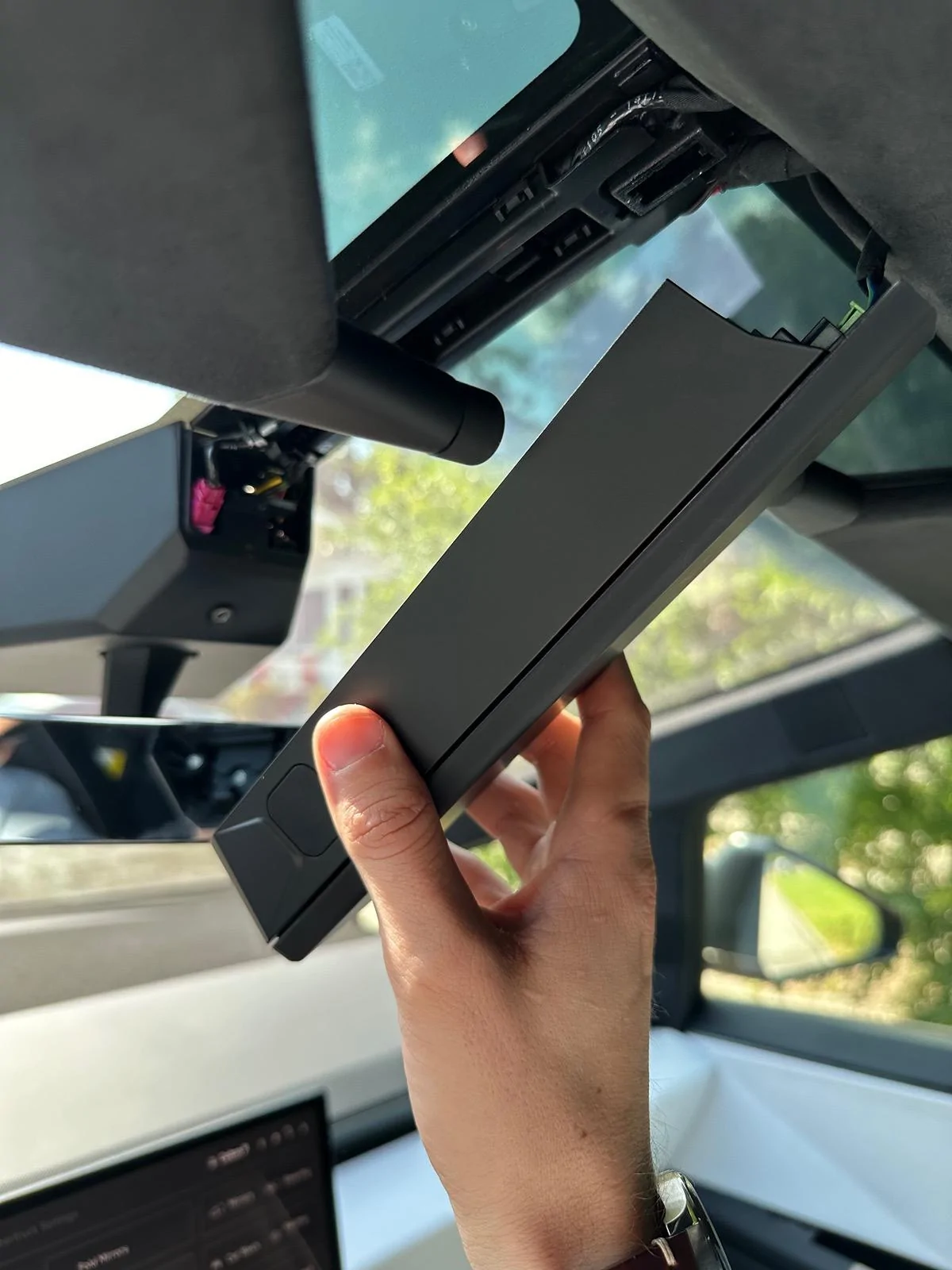

Overhead gear selector falling off

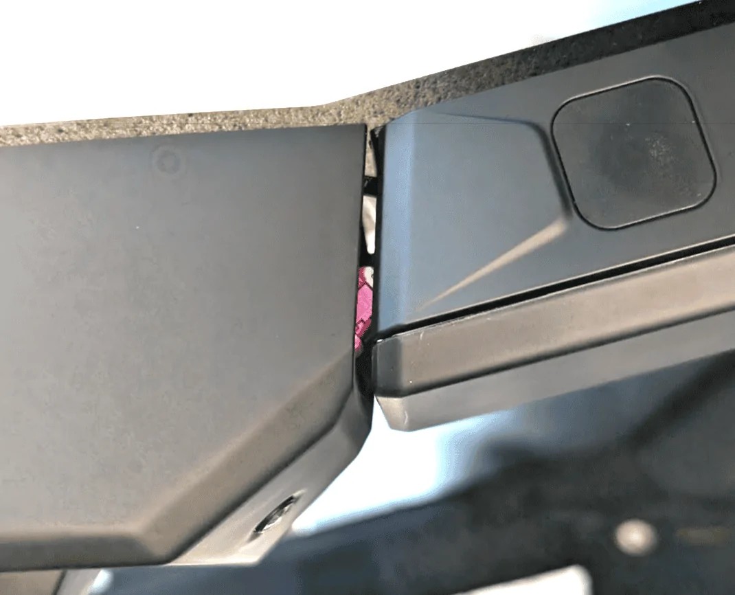

I was able to fix this myself. I filed off just a tad of the white clips where they grip to the frame to make gripping plane angle sharper. Then installed small rubber stuff under the base of each white clip to make them always wanted to expand. These 2 mods cased clips to grip stronger - has been holding strong for couple of months now

How much of a gap should there be?
