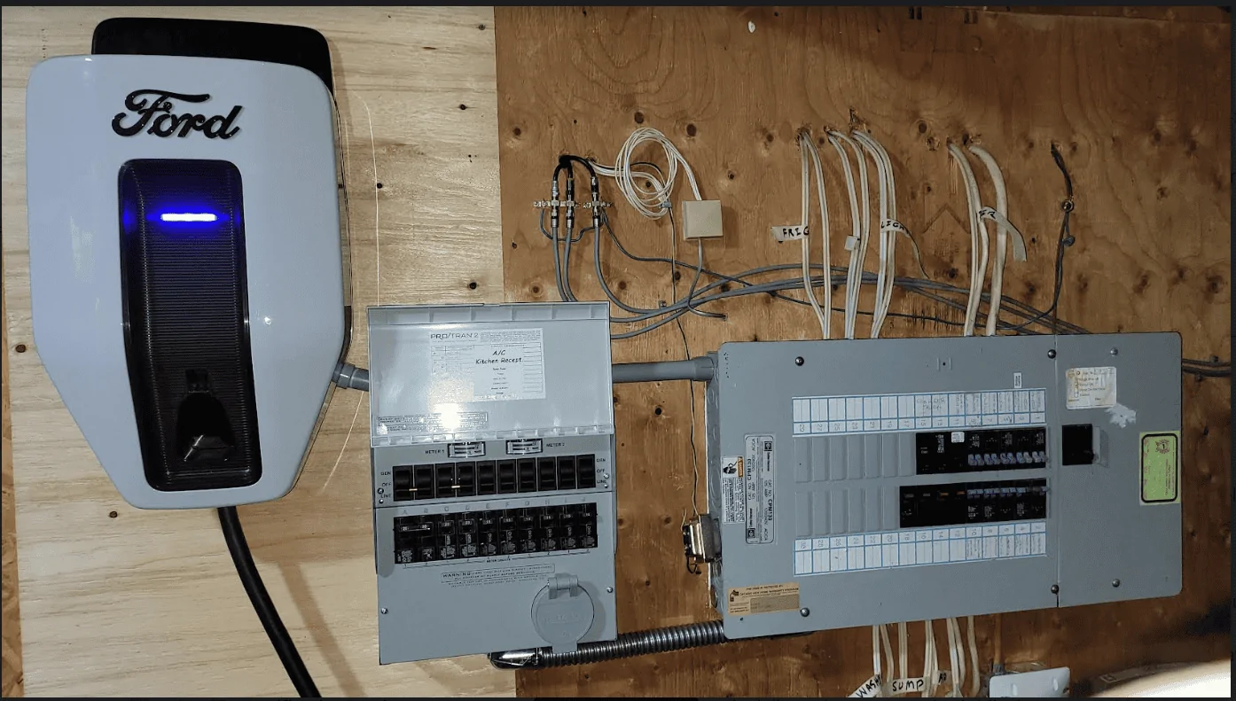

I just went simple if power goes out I plug in the truck. Low cost setup. 2 x 240 volt 30amp 8 x 120 volt 15 amp curcuits. This cost me a total $1,100.00 CAD. It helped that my panel is in the garage.;)

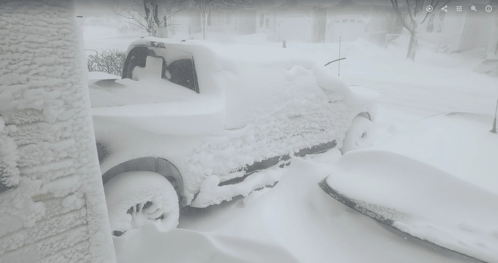

Keeping the Home Heat and lights on during winter blizzard power outage!!! Calculated 200 hours run time with 30% battery at cut off. Will vary by load use.;)
That was a very interesting night. We knew the storm was coming, so I setup the charging on the truck to 100%. I plugged in the cable from the truck to the transfer switch in the garage. We waited. Just after dark sure enough the power dropped out. Turned on the truck, turned on the pro power. All good.
We watch the storm out the windows I could see about ever other of my neighbours up and down the street had power. Genac salesman made a good amout of sales here. Anyways about 1 hour into the blackout I noticed no one had power!! I found out later the Genacs were failing left and right. The poor service guy was out there all night fixing the units. The main problem was the snow was plugging the air intake filters stalling the generators.

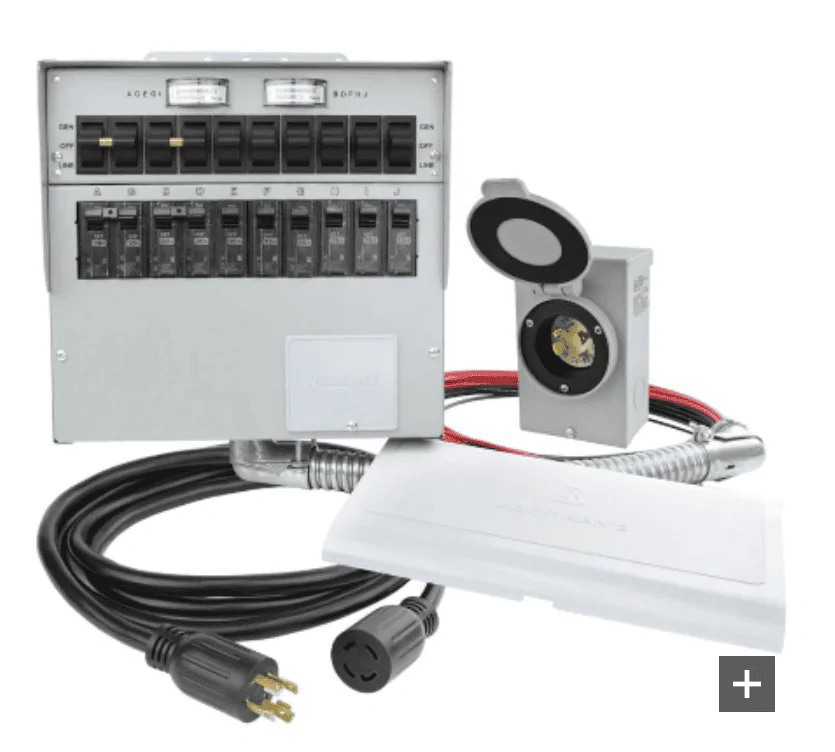

Around $700.00 Reliance Controls 30 Amp 7500W 10-Circuit Indoor Transfer Switch Kit
Model # 310CRK|Store SKU # 1001061741 Canadian Home Depot US unit maybe different.
I took the generator connector plug out of the remote outside box, and installed it in the optional position in the transfer switch panel. Since the Lightning has no gas fumes I kept the system all in the garage.
