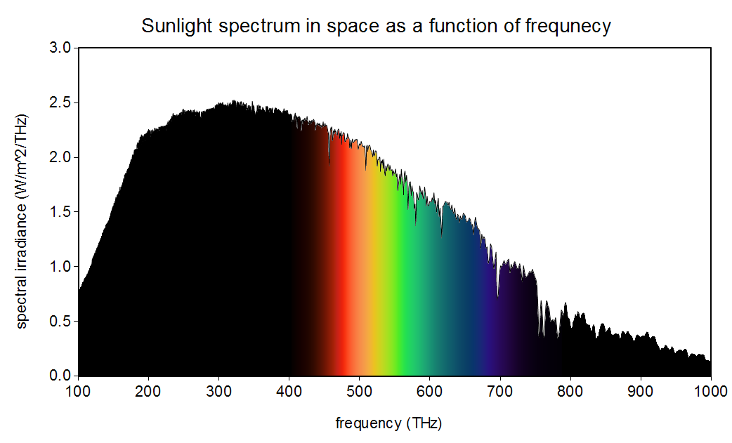

Here is a frequency chart that shows just how much of sunlight is not visible. Please notice that it's a frequency and not a wavelength chart. Black color materials absorbs visible light but could be IR reflective and therefore cooler that a white color material. Additionally emission of light can be important in temperature, some materials absorb energy in part of the spectrum and re emit it in other part of spectrum.
So something could be mirror in visible spectrum and still absorb the IR parts and not re emit it will get really hot in sunlight.

The way this works is that visible and NIR light strikes the outside of the skin and is partially absorbed causing the skin to get hot which in turn causes it to reradiate some heat to the outside and some to the inside but at longer (IR) wavelengths. Thus we want the skin to be highly reflective (light colors, smooth surface) on the outside and low emissivity on the inside. Stainless has, intrinsically, low emissivity and they make it even lower by putting insulation between the cabin and the skin. The real consideration with interior temperature is, of course, not the skin but the glass which transmits visible and NIR and blocks any IR that tries to escape.
